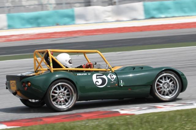

Picture attached of the car in action yesterday at Sepang, the MGB is a 4.6 Rover V8 500 plus Bhp and under 100Kg and both it and the Phoenix were lapping Sepang in 2m 33s and within ½ a tenth of each other, which is an Average speed 81 Mph, Speed through the speed trap 130mph, actually overtook the TVR 5000 in the picture here, first in class, http://www.classicworldracing.co.uk/team.html (the Corvette in the picture is not so nice today it went into the wall at turn 4 on Saturday and the front is 4inches to far to the right now) and only beaten by a 427 Mustang. Now the Sepang straights are two huge engine eaters not really suited to the JP concept of small agile cars (hence the turbo), but I think only being beaten by American V8 is not bad.

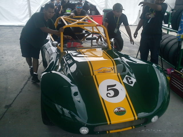

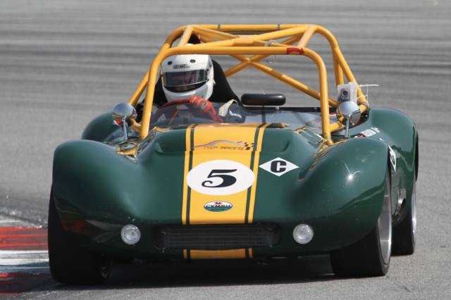

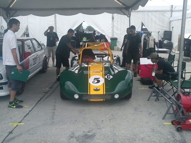

Ok I've worked out how to use the phone camers at last so a few photos, this is Sepang a few weeks ago, car colour is because it did have an Esprit S4 engine and was registered in Uk as a Lotus Sunbeam, which is how it got to Malaysia a kit/Sylva would not get in as the car needs an ' approval' and is checked against a list of approved cars, just the vin plate.

Hi Rob, the front ARB mounting has been heavely modified by my race mechanic, who is actually a chassie man by training, and is working well, he is currently working on a rear ARB.
