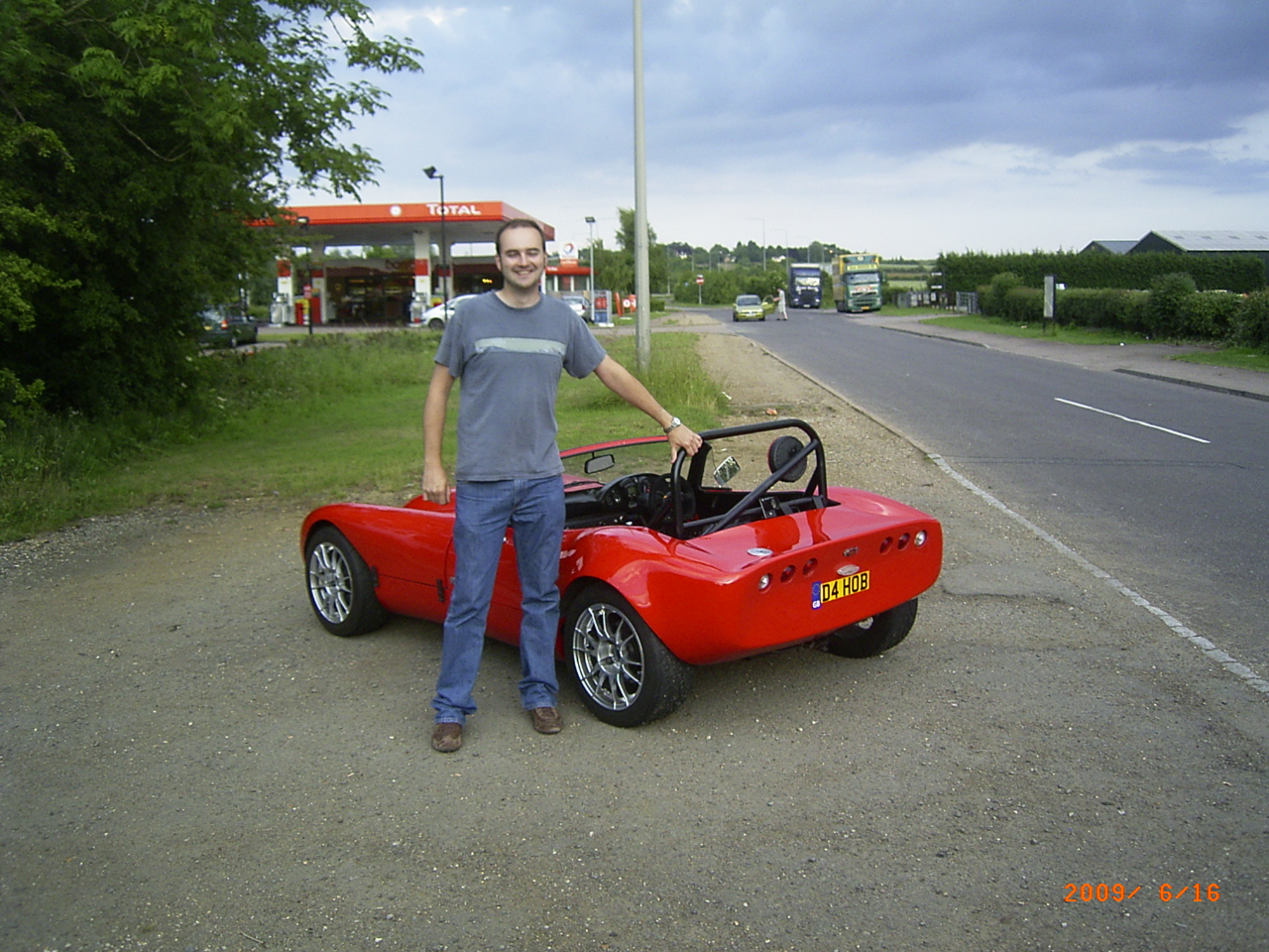

Last night , I met David Hobbs with his Fury BEC half way between us , to supply an ARB for him to fit before he goes off on Friday for a 2000 mile tour around europe
Made it Monday am -- delivered it last night
I did have some levers already cut and drilled though which helped
Here's David with his Fury which has been raced in the SCOTTISH SPORTS & SALOON CAR series before he bought it

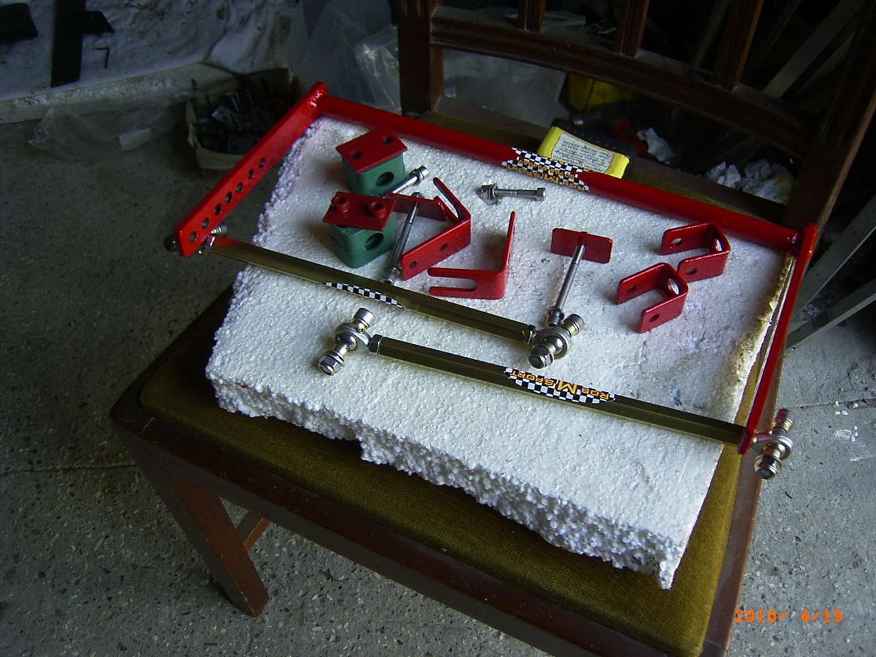

Cost will be £8 per pair -- ie. a pair will hold one ARB
Anyone fearing Kelvin's experience just CONTACT ME

Here's a kit for an R1 Phoenix ready to go. If you look at the green poly clamps you'll see these new top plates I'm talking about
