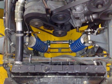

I have been fitting my ARB over the last few days (to cold to stay out long & Im trying to do it whilst the car is on the trailer). It fitted exactly as the instructions say. The only reason I didnt do it earlier is a water pipe was in the way.
Glad it went together well . One thing I could have said is fit it all apart from connecting the link rods , up on jacks for easy working BUT leave fitting the link rods until the weight of the car is on the ground. That way there will be no pre--tension by fitting/adjusting the rods to possibly unequal lengths due to imperfections in the suspension drop when on jacks . Being unequal/adjusted to fit once the car's on the ground isn't a problem. Common sense really so forgot to say

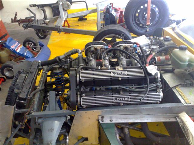

Looks like you already haveBerw wrote:OK hello to everyone, I’m the guy in Malaysia, just registered here, look an interesting/active forum.
To start off very pleased with the ARB, haven’t tried it yet, on the road, as curcit is closed for the F1, but looking to tow the car south to Johor Baroh, Malaysia's second track in next few weeks, but fitting was easy, all matched up as supplied, only problem was that it fouled my electric water pump, and I had to make new brackets and get new hoses to move it an inch or two,
