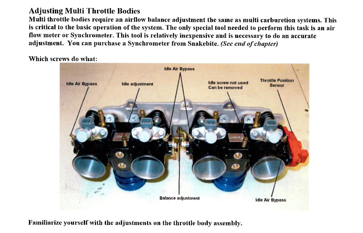

I have the original weber installation guide so I am going to purchase a syncometer as they call it and follow the procedure for throttle Pot and body balance. The POT is mounted on the right hand body (weber manual shows it on the left) which may cause issue as the left hand body is the lead in the throttle linkage, thus if I adjust the right hand stop I am going to struggle to get the left hand to behave in the same way (left to right the balance screw will transfer any force from butterfly spindle right to left a spring damps the movement so it is difficult to control left butterfly opening by adjustment of right hand body throttle stop- hope that makes sense to someone!). The weber manual says to back of stops and ensure throttle is closed and adjust POT to correct 0% voltage- easy enough. Then move on to adjusting LH stop to set the pot until the correct voltage is given- this is where issue arises without the balance adjustment correct and the POT on the RH body this will be difficult, and likewise if I was to go visa versa and adjust the right hand stop due to the linkage this would not transfer through to the left. Think the solution is to either move the POT to the Left hand body- not sure how possible this will be yet or change the throttle linkage to lead with the right ( I say change but will probably mean replace). Anyway rest of the procedure seams straight forward, run engine till warm and balance bodies using syncormeter, use air bypass screws (which until now should have been closed) to give fine adjustment between chokes and body finally adjust tick over correctly piece of cake!
Has anyone done this to weber bodies? I believe from a quick search last night the Jenvy etc bodies do not have the air bypass adjustment I may be wrong though. would like to confirm screw idents, am I correct in thinking the air bypass screw is the wee screw next to injectors on the body?, stop and balance screws are obvious. I should have taken a photo but never got a chance.

Re: Little BRG Stylus SOLD NOW !
Don't know the answer (only ever had Jenveys).
Guess you already have the Zetec version of this doc
http://www.webcon.co.uk/Downloads/K2400 ... 006-01.pdf
ALPHA Performance Kit Fitting Instructions K24001 (DURATEC)
Page 18 Throttle Body (Idle speed) Adjustment Procedure
Or if you want to see how the yanks build a 7, try this...
http://www.secondstrike.com/Technical/S ... Manual.pdf (137 page PDF, larger file)
Pic from that manual attached
I have the zetec manual and the procedure outlined is more or less the same, picture says a thousand words though and the section in the larger manual is very useful although he setup is slightly different than the weber way. Think I may be wrong about the use of the screw on the right though, will need to adjust using the left, still think this is a long winded way of doing it though as will mean you are potentially adjusting the idle based on TPS position when there is an error in the balance link you would then need to adjust the balance link correctly and reset the idle, if I was to set the TPS position using the stop screw on the RH body to obtain the correct TPS voltage and then set the balance to match the LH based on syncormeter reading would save a step, perhaps I am over simplifying.
