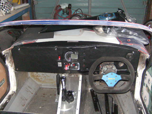

well car not sprayed yet cos been to damp round here (no heating in garage)but had an atempt to panal out the in side see photo. tryed my hand at making a dash as well so heres a photo of that as well. also round the hand brake.at the end of the dash at ether side im not to sure on what i shud do. need to think about that one i have even made the gaters for the gear leaver. one thing i have found out is i need to get some proper tools lol and a biger garage.

Wow! very tidy job there!

it was quite easy to make really. just a bit of 30mm ally angle for cross the top rivitied. but i tried to make it so it followed the angle of the brake lever . the measurements for mine are front face as u look at photo 200mm at top and 180mm at bottom depth 30mm then 20mm for bolting as its made to be a removable panal then i used rivnuts to fix to main tunnel panal .sorry if i havent expalined very well but not that good at puting things on paper. i have tried to put the dimensions to photo for u

Thanks for that, will have to give it a go
