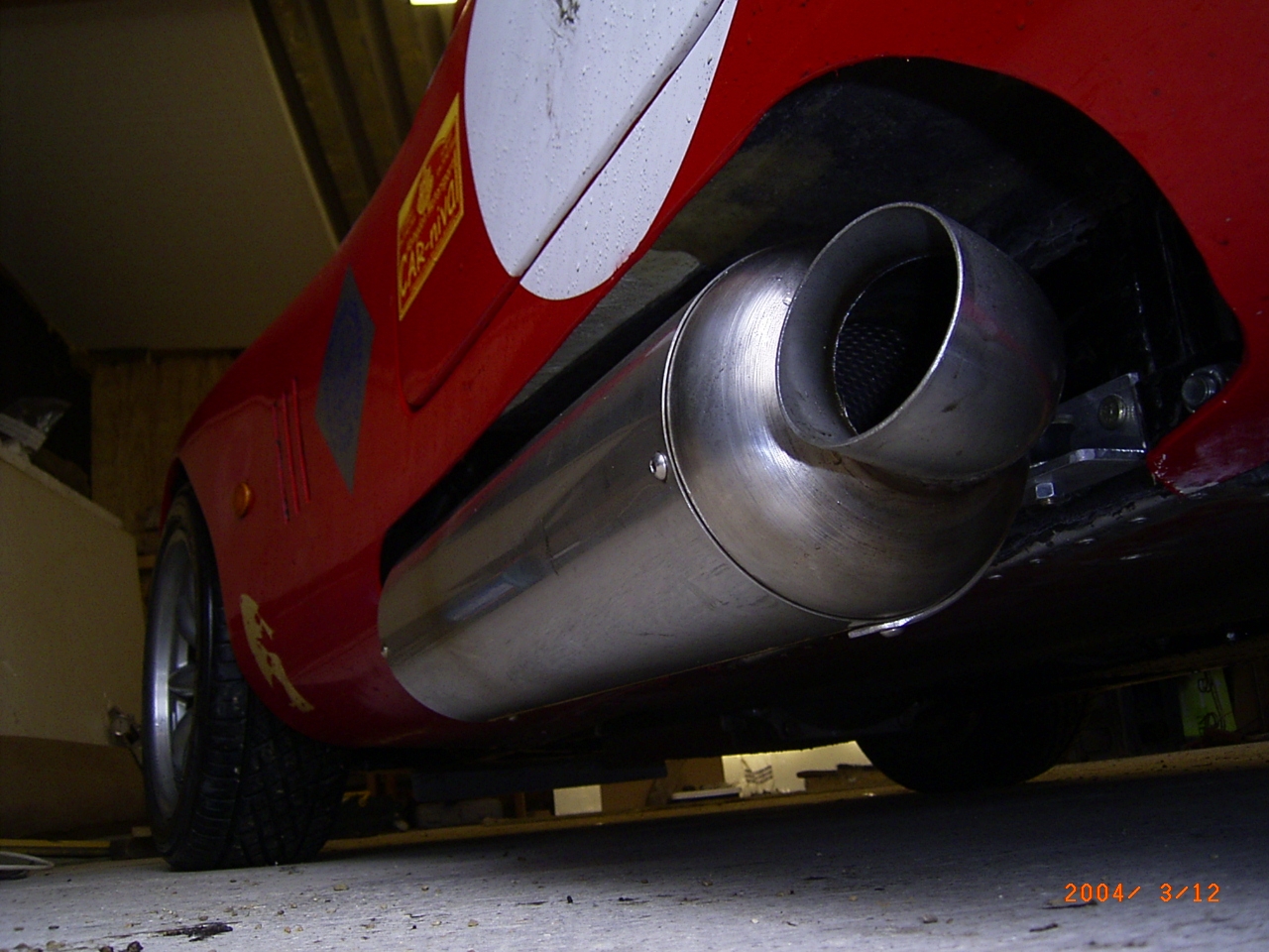

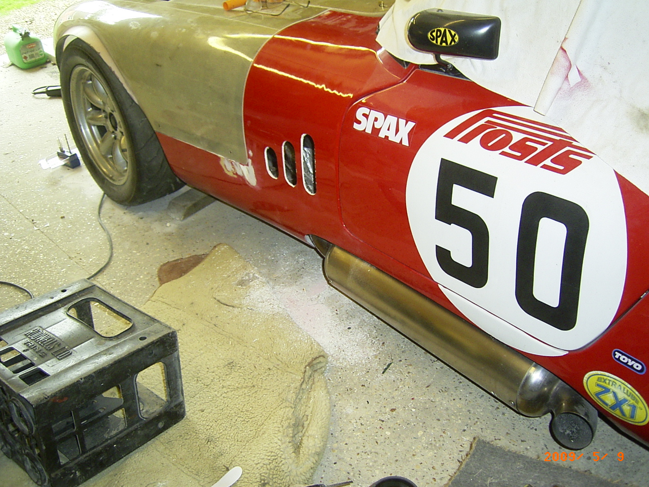

Re: exhaust tailpipe
Like this but in the sill and a rounded pipe exit edge
It's about 22 inches long and 6 inches diameter including domed ends with a 2.75 inch through pipe. I got from my friend who aquired it from Steve Broughton SBD , as SBD were changing to a 7 inch silencer on their dyno at the time. As you can see it's repackable and was made by BTB in Daventry. BTB will make any size you require and sound test it to your bhp needs. I doubt you'll need a 2.75 inch through pipe though unless you have 230bhp plus.spegru wrote:I quite like that look.
There's no problem with strength by cutting out that area as I've done . The door sill to silencer f/glass cut line is 50mm's which retains the strength --- absolutely no body sag , droopspegru wrote:Thanks for that.

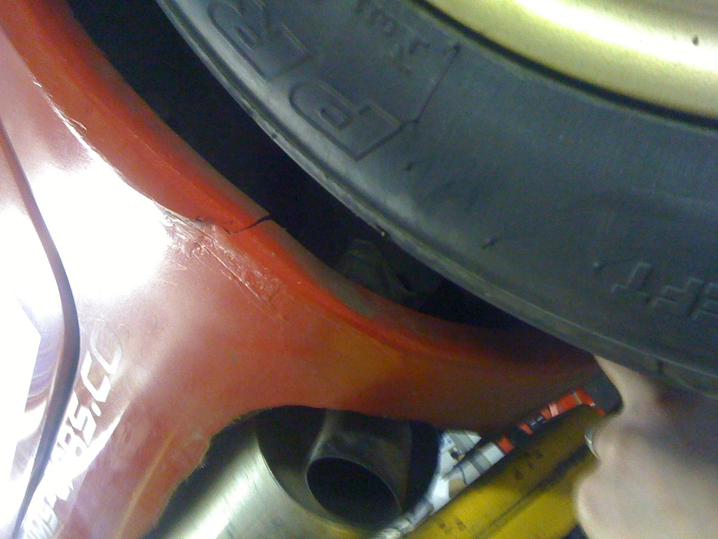

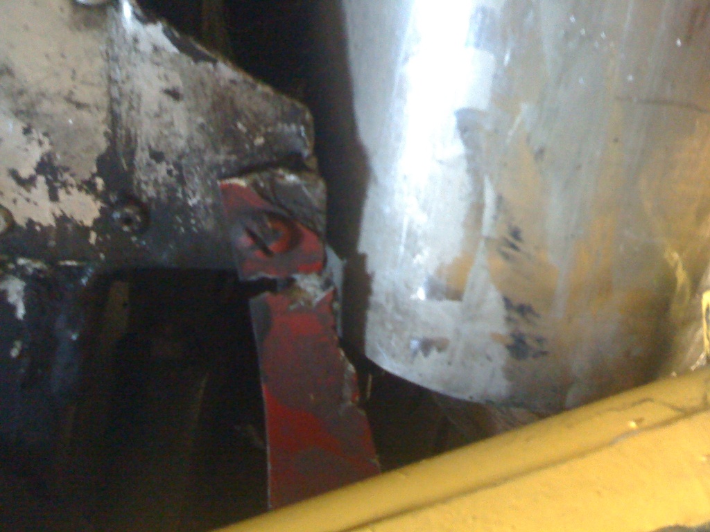

[quote="spegru"]Thanks for that.
One thing I am a little concerned about is the strength of the sill and/or body since right now it's rivetted to the floor.
Does the bottom of the door opening move if you lean on it?, and is there any sign of the front and rear body sections sagging?[quote]
Found this..... during my rebuild inspection, so something to look out for.
The door itself & the door aperture/opening is fine.
Most likely because I cut too much away in the first place
Hmm, looks a bit nasty. I notice your silencer has square ends rather than domed, so I suppose you had to cut more away (and maybe it was even hitting the body sometimes).
What length is the box? Does it go all the way to the front arch as well?
Diameter is also important - looks like you have 6" dia?
