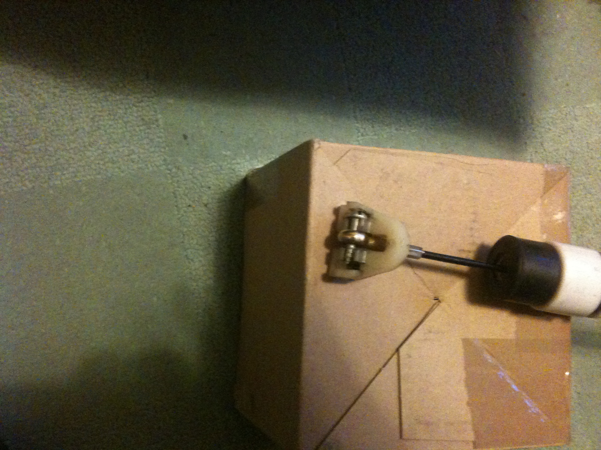

Just snapped my bloody clutch cable!
Mine has a clevis end, anyone recognise it?

Re: Zetec/Type 9 Clutch Cable
Escort pedal end attachment's like this , where the plastic moulding slots into the top of the pedal BUT obviously not with the screw you see in this photo
I've fitted a Cortina one which comes with a round end and made a couple of plates to turn it into a clevis.
Lateral thinking ---- like itse7ensport wrote:I've fitted a Cortina one which comes with a round end and made a couple of plates to turn it into a clevis.
