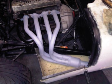

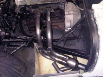

Re: 4AGE engine and bonnet clearance
I have had some pics through from Nev today.
Looking good so far!
