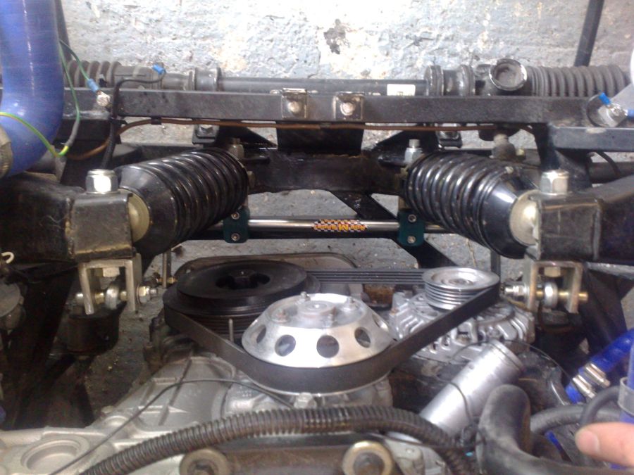

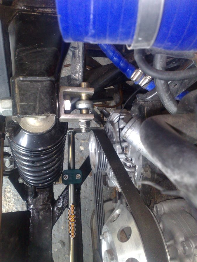

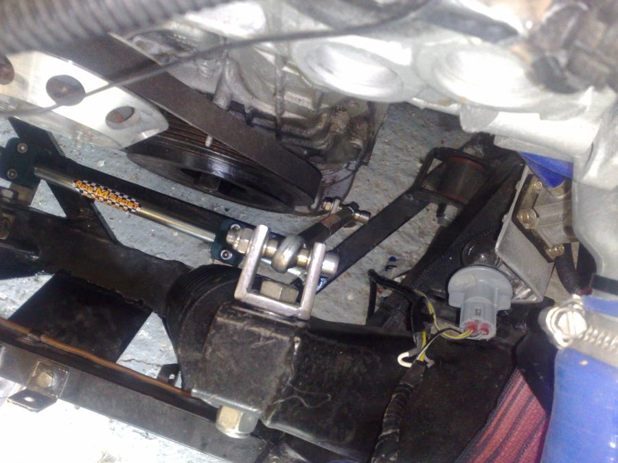

Thought these might be useful. As we we're fitting the new rad we thought we'd tacke the ARB. First problem we had was we had moved one fo the diagnal bottom chassis rails so we had to add a new one in from the mounting hole. We then discovered we could not use the furthest of the three holes on the arb bar as it fouled both the engine on one side and the alternator on the other, so we've used the middle hole and cut the ends off for extra clearance.
Apart from that it all went on fine. We didn't have to use cap head bolts of the tops of the springs, just wedged a large screwdriver down the side when we tightened it.
I jumped up and down with all 13 stone and couldn't make the arb arms hit the bottom rails, so I thing all is ok.
